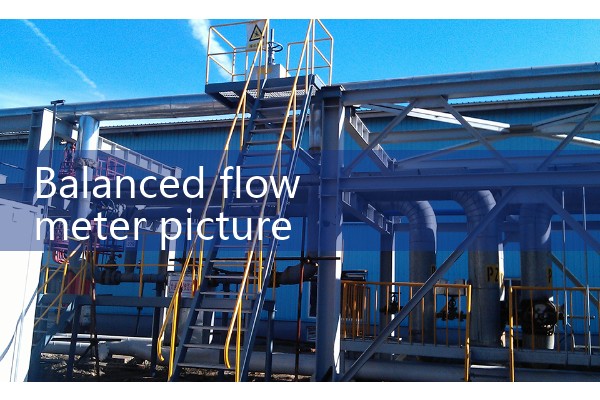

1. Can the balance flowmeter be installed vertically?
Here is a schematic diagram of the installation of the balance flowmeter. When installing on pipelines, both horizontal and vertical pipelines can be installed with the same thickness and width, while ensuring the straight pipe section. The measurement medium is different, and there are slight differences in the position selection. Please refer to the detailed instructions in the stool book. The correctness of the installation in the early stage directly affects the measurement accuracy.
