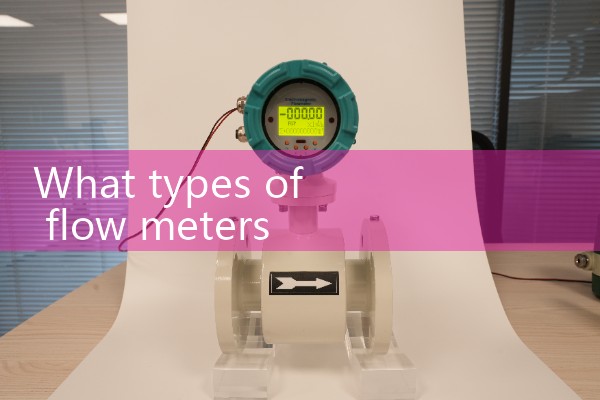

. 1. Turbine flowmeter: Relying on the rotational speed of the impeller with the fluid to correspond to the flow velocity, it has high accuracy and is only suitable for measuring clean liquids and gases, such as tap water and natural gas. It is necessary to regularly clean the impurities attached to the impeller. 4. Based on Faradays law of electromagnetic induction, electromagnetic flow meters can only measure the flow rate of conductive media and are not affected by fluid density, viscosity, or temperature. 1. Integrated electromagnetic flowmeter: The sensor and converter are integrated, easy to install, and suitable for conductive media such as sewage, acidic and alkaline solutions, and mud. During installation, it is necessary to ensure that the electrode is flush with the inner wall of the pipeline to avoid disorderly operation of the pipeline. 2. Clamp on electromagnetic flowmeter: does not require pipe breaking installation, suitable for old pipeline renovation scenarios, only suitable for clean conductive media.
